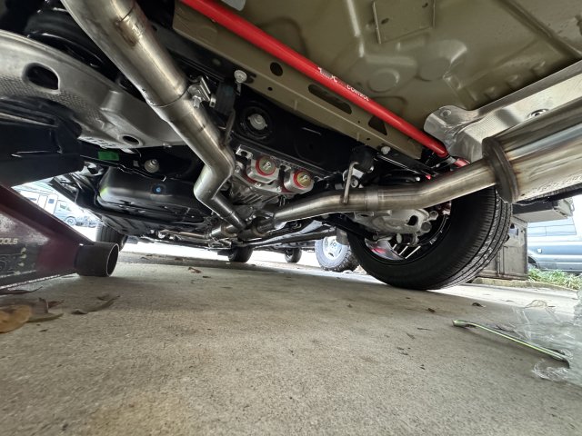

Elective maintenance - About 100 miles away from 10K miles on my 25' ST. I Changed the front diff. fluid and the transfer case fluid on Saturday. Changed the rear diff. fluid yesterday. How nice of Ford to put the rear diff. fill plug and a cross brace just over an inch apart from one another..
I wanted all the "break-in" drivetrain fluids changed since I've made a few trips from Michigan to West Virginia to ride the HMT trails with my ATV's and dirt bikes. I Pull close too, or at the max GVWR and GCWR on these trips in the steep mountains with my trailer and interior totally loaded. When you're going on week long trips like this you take everything including the kitchen sink with you.
The front diff. fluid was pretty black and smelly with the normal fine particles on the magnetic drain plug. The transfer case fluid looked brand new and the rear diff. fluid looked surprisingly clean with not much particle wise on the magnetic drain plug.

The front diff only holds .6 of a quart and the fluid is a lot thicker than the rear diff. which holds 2 qts. (1.9 but who's not adding the remaining 3.4 oz. left in the container..) The front fluid color and smell were normal IMO because of those factors.

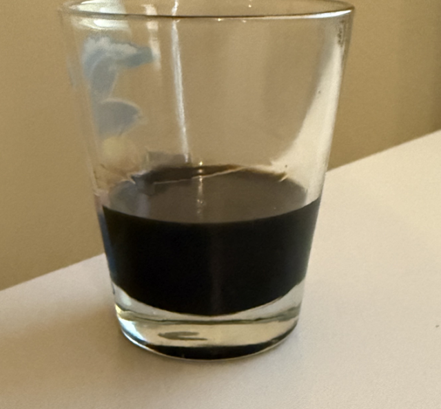

Catch can: 3 months, 2650 miles.
292
139
2025 ST
What's your thoughts on the amount of oil?
Looks like a shot glass which would look like a normal amount for 2600 miles.

It’s my first catch can so I don’t really have an opinion other than why the frag would you circulate that garbage back in. But I’m not an engineer. Sooo.
292
139
2025 ST
Additionally, removing oil vapor from the intake tract reduces the possibility of it contributing to knock.

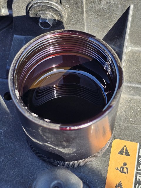

And that stuff stinks. It looks like jager lol but sure doesn’t smell like it.

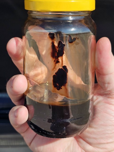

Emptied mine out today too. Probably let it go for a little too long, it was pretty full.
This is all that's accumulated since I've owned it, about 12,000 miles worth.
