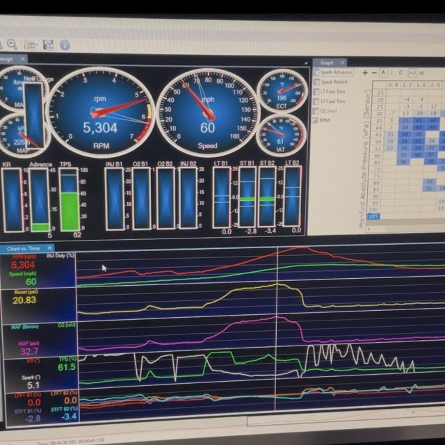

Finally got a tune in! ZFG DMS 91 at 6,000ft altitude made almost 21lbs. She pulls hard. This is just the base tune and needs revisions.

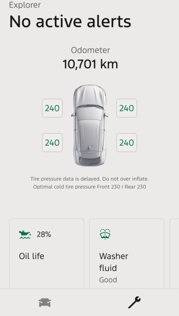

Mines done 6650 miles and still has 28% oil life left before it's first change is due LOL
If it was mine the first oil change would have been done a while ago. Most people change at 5000 miles or even less.
