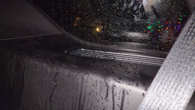

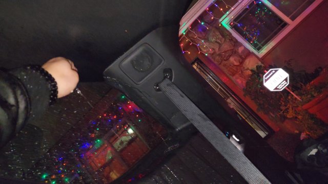

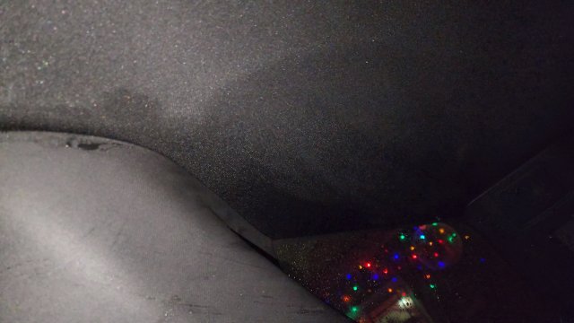

Quite a bit issue on a 25k, 2 year old Explorer Platinum. Currently, in Cali we experiencing "hard rain". Luckily for me, I happen to notice water was leaking on the rear by the hatch/3rd row seat last night.
I'm guessing it is due to assembly missing the infamous sun/moon roof water tube. We've had rain in the past and I have taken it to car washes before in the 1.6 years of owning it but never seen water leaking, or maybe never paid attention?
Anyways, it's never smelled like mold, so hopefully it's not a huge issue. We also never had strong rain, we been in a "drought" for a couple of years now.

I had a leak back in the same area and it was the moon roof drain hose. Dealer fixed it no problem since.
Great to hear that! I have seen some people post on other sites where they had to gut down the whole interior as there was water in the 2nd row as well.

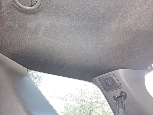

The leak on mine actually started showing on the roof from the end of the 2nd row but the actual leaking was on the 3rd row. There was some water also on the 3rd seats. Just wondering what exactly would be replaced, if anything

Just out of curiosity, have you checked the spare tire well? I wish I could remember where I had read the different reports but I've heard reports of the moon roof drain, a seal leaking around the back side window, and the rear hatch seal all causing problems. I hope yours is an easy fix.
No water in the spare tire, I did have a kids blanket that got soaked but that was due to the leak from the top. I did see that post, I believe they had to remove the rear bumper to add the seal.

I had the issue on my '20 ST, was rear moonroof drain hose kinked inside that pillar.

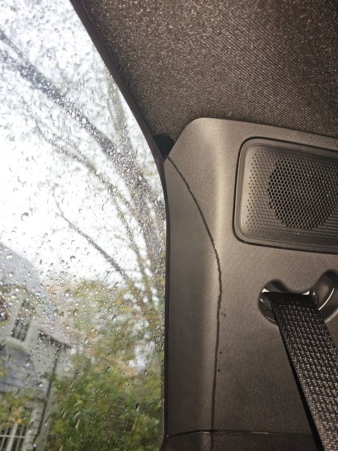

I've got a '20 with 36k on it. Thanks for these other posts. Not sure which of the above issues I have, but wanted to post photos of where water has been leaking in over the top right of the rear. Car has smelled musty lately and I had a tech look at this last visit ('couldn't find anything....') Big rain last night. When this happens, it usually pools in the rubber rear mat I have so it isn't getting into anything further down in to the car. Wanted to post these pix for others that could use them. I've got a service appt in 2 weeks, so I'll have them look deeper into this then. Any DIY suggestions are welcome. (will look up cleaning moonroof drains, but would be surprised if that's the issue on this mostly garaged car.)

I had the same problem that DgoebeI57 had in post #9. Rear roof drain kinked. Dealer repaired no problem since then.
