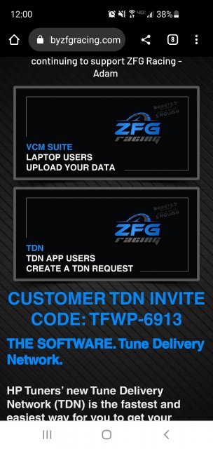

No.. Just sent it throught the TDN app. Am I supposed to fill out a form on his website? Maybe that why i have not heard anything from him since i sent the file! Ughhhh
Yes, every single time you send anything from tdn you also have to do request form thru website. I wrote my order # and device serial number down on a piece of paper that I leave in the ST just to make it less painless each time.

From his website you click on tuning central, have to make an account if you haven't already, then click on tune request form.

Yes I found it and just submitted my info! damn....Thanks for the assist! Now I know what to do! waiting all this time and i never even completed the process! LOL...
