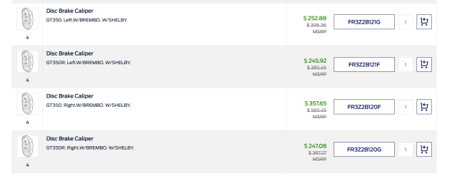

I'm not sure the GT350 upgrade is viable anymore. I started pricing out the modern cost, with this Facebook post as the parts and price guide. It ain't pretty now, and honestly I gave up once I failed to find the calipers anywhere. New price is from Tasca.

3. GT350R Front RH Caliper - FR3V-2010-BE ---- was $272.58
4. GT350 Front LH Caliper - FR3V-2011-BE ------ was $272.58
I dunno, those calipers look like they're everywhere.
https://parts.lakelandford.com/a/Fo...ront-suspension-Brake-components/JC15395.html
They're all over eBay too.
I think the F and G suffix on the part# denotes the color (red or black)?
