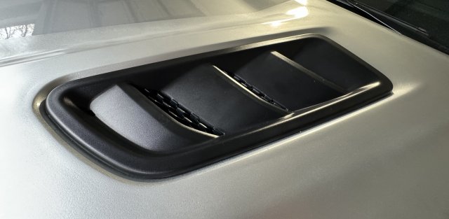

I’ve always welded panels and I was ready to TIG these but a friend that does this stuff for a living said this is the way forward with aluminum.

Here we go…test fit for placement.
Gonna need a bigger hole.
Bigger hole cut and edge flanged all around so the pieces fit flush.
Final test fits.
Panel bonded and riveted into place. Once it dries overnight I’ll remove the rivets then final body work can start.

@UNBROKEN, Are you tying this into the intake, using it to evacuate hot air or is it primarily a visual effect?
Getting heat out of the engine bay. I just wanted to look factory.

It’s even better than I hoped…it was worth the effort to hunt down the Jeep hood even if it did take half a year. IMG_2315.jpeg

The sun was just right and it hid the primer…I almost got a “completed” shot. lol IMG_2330.jpeg

Parts are prepped and ready…gonna try to get them fit and bonded in tomorrow or Sat then it’s gonna be ugly for a while. Never used panel bond before so I’m gonna drive with it a while in primer to make sure nothing cracks.
That stuff works amazing. I had to use that to repair the tabs at the bottom of my mustang back in the day.
