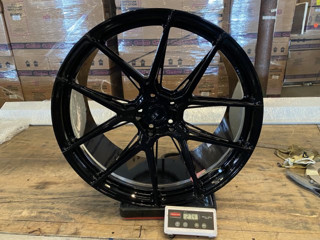

They’re here...and they’re light AF. 0EE41407-5FFD-48E7-953D-A164AC1EB495.jpeg AD6E9704-7ED5-4E88-83F8-365CD9DBD6F6.jpeg

Test fit complete...tires and mounting them up tomorrow.

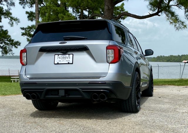

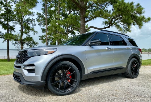

467C6C8F-D7C3-47D0-978E-B1FF78AD4F14.jpeg 4AEF56CB-9A1E-4CAC-B1FB-C1273130DB1D.jpeg D694B9D8-8FFB-45CB-A2B2-544C9B15D638.jpeg
Done...and I can brag that I fuckin nailed the math. Dead flush all around and the fenders are just stuffed.

No spacer. I dialed it in with the rear camber. -.5 is perfect.

10.5 wide, +30 offset and 305/35’s

No rub...not even close. There’s about 5/8” clearance on the strut body and a fat finger width between the corner of the tire and anything in the fender when turning lock to lock.
