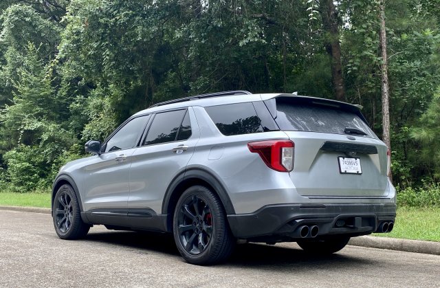

Thread Starter #46
It’s filthy but it’s dropped. Maybe it’ll quit raining in Houston sometime this year and I’ll wash it. 18A83C77-667A-48F2-80E1-C8540036C633.jpeg D683B061-30FA-4558-B7F6-DD9CDCF1D30B.jpeg 160FC746-17EB-435D-AAF9-2BFEF52E99A4.jpeg

Thread Starter #48
How does it ride compared to stock? I just picked up my ST on Tuesday and was planning to do this ASAP.
I like it a lot. Firmer but not harsh. You won’t regret it.
