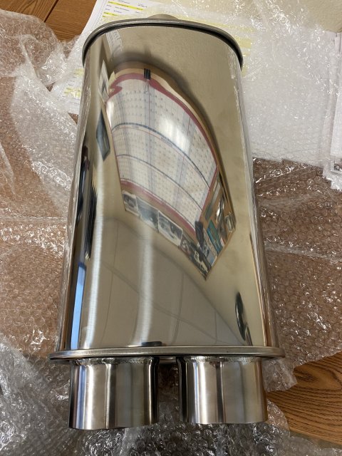

More exhaust experiments tomorrow. Swapping the Magnaflow 12298’s for Vibrant 1136’s...and I may be a little anal about having straight exhaust tips. lol D6DEC732-4DAA-4361-8D73-C8EAA8222DD9.jpeg 58A787FA-E10A-461E-9575-9F0DDF901B7D.jpeg 52F307A2-6748-456B-BB98-C217B18A19A8.jpeg

Swapped the mufflers out...100% lateral move from the Magnaflows. No change in tone or volume I can discern and still shows a peak in cabin of 187hz. Looks like I’ll be building another set of resonators and leaving it alone now.
If anyone was looking to build a system though I’d recommend the Vibrants based on length alone...being 3” shorter than the Magnaflows makes packaging a lot easier.
