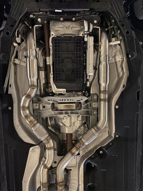

Prep work for the exhaust. It looks long but it’s the same overall length as the oem muffler and tips I added. 2FBAE90B-21AE-4701-B0B8-74E1F083D55A.jpeg

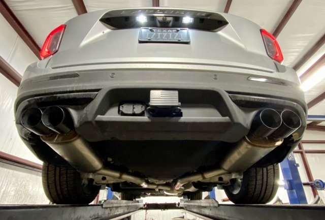

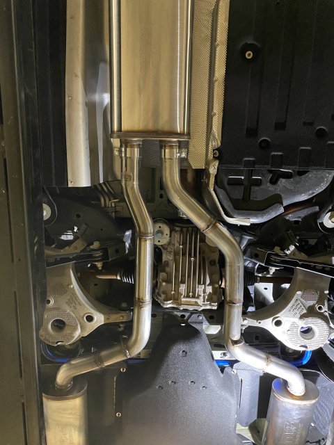

Exhaust done. Sounds great and I’ll have clips today. Zero drone but I can hear it on the highway...I think maybe that’s just how an SUV is with the tip exit just below the lift gate. I think some sound treatments in the lift gate and spare tire well will knock most of it out. E5C42C3A-2055-413E-8C9B-958641C1D192.jpeg B2778E12-EC92-4FE6-8DB7-1CA0E5AF54AE.jpeg 558CB8C7-03C5-400E-AFF1-11A742E4E426.jpeg B557D860-8B2F-4AC6-9205-BBF2C137D256.jpeg

I wanted deep and nice...not raspy and loud. I’ll get WOT vid in a bit.

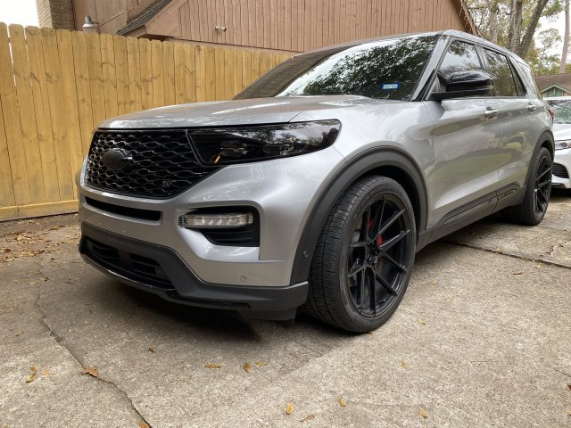

Teaching myself how to wrap stuff. I used transparent Vvivid air release film and knifeless tape to wrap the top of the heads to hide the chrome. I think it’s too dark so I’m gonna order a lighter smoke. It’s not perfect but I like figuring things out so maybe the next shot will be better...

Looks good to me. Maybe in person it looks too dark? But these pictures look great.

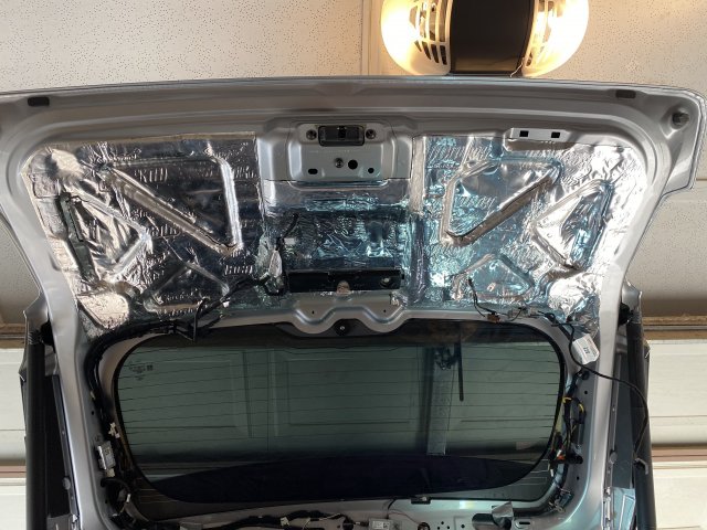

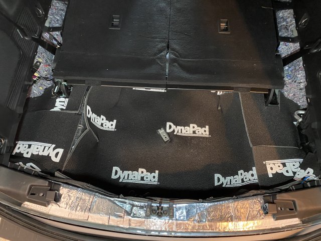

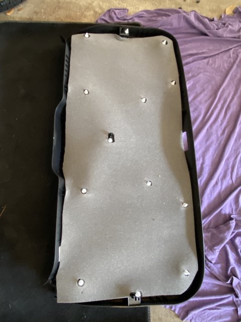

43C8BB35-8A96-48CB-A81F-361CC919E1D8.jpeg B090FA61-C324-4697-842F-FA950D88F6D0.jpeg F44773C0-EF96-4301-8D09-006F1D6F01BE.jpeg DFA72935-3D4F-491B-B9B8-26028CCA0917.jpeg Working in sections when I have free time for audio prep. CLD and a CCF/MLV sandwich. Should have all 4 doors done by New Years. I went 100% with the CLD since I’m trying to target some exhaust noise...figure overkill would be ok here. I like the Dynapad too...super easy to work with. I still have to tape the joints but I got it in the rear floor and lift gate pretty good I guess. She’s gonna be Rolls Royce quiet when I’m done.

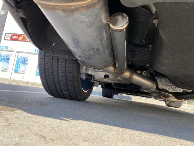

So after my new mufflers burned in I wound up with a touch of drone...about 187hz at 2000rpm. A little math, a little welding and bam...a pair of 1/4 wave resonators added and the drone is dead.

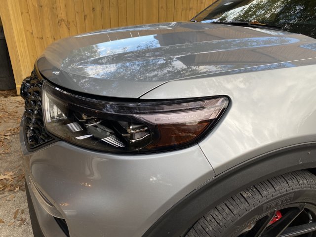

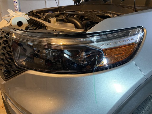

Reworked the upper headlight tint with a lighter version. I like it much better...you can still see the details inside the lights instead of looking like paint. Last pic is the old dark tint.

I like the lighter tint better. Does it cut down on output much?
There’s no tint over the actual bulbs. I only tinted the top chrome portion.
