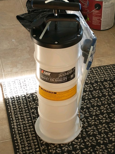

They make a similar one. I got the EWK 6.5L Manual pump. Use the smaller of the 2 tubes supplied. With filter changed also, of course, added 5 1/4 quarts . IMG_20210515_083042397.jpg
That's odd. I add 6qts exactly with every oil change using the extractor method. Have done 3 and each time the same.

Used the HF oil extracter. Pulled 6 qts of oil out of the dip stick tube. Changed the filter. Had to bend over one time. Dropped my damn rag. I am a believer.
Okay, sounds good. I was thinking 5 1/2 quarts was a full change. I will see what amount I can pull out at next change.

I never measure what i pull out. After 10k miles you might be almost a quart low and that's normal. If you are adding much less than 6 qts fill, I'd double or triple check to make sure you're at the full line on your dipstick. That's all that I was saying.
