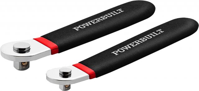

I used factory specified oil, mostly from Rockauto or Amazon. The rear diff fill bolt has limited clearance--You will need a low profile 3/8" socket driver or lever. The front diff fill bolt is tight...I needed a breaker bar. Refer to the online service manual. Pretty straight forward.

Do you have a recommended low-profile socket? I have found a couple on Amazon but not sure of their quality. Thanks.
I happen to have a small pivoting socket driver that happen to barely work. Look at your socket driver and see how thick it is. Some say theirs worked. All my regular socket drivers were too thick including my 1/4" drivers.
I bought this for next time:
https://a.co/d/ipn8v5n

Thanks everyone! @Cdubya your reply came clutch during last minute tool gathering. Ended up getting something similar to this but never ended up getting to use it...
