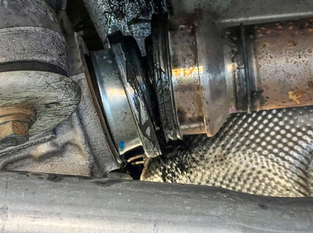

Well bad news for me. I have a 2021 ST with 12,000 miles on it. I notice some hard down shifting several different times. A couple days ago I got off the freeway it downshifted hard I turned the corner and accelerated and it immediately downshifted very hard and it was like an explosion the whole car shuttered it was very loud and now the the vehicle barely runs. I was told it would take a week for the dealership to look at it so I’m just waiting till next week to hear what’s up, I’m assuming it’s the trans

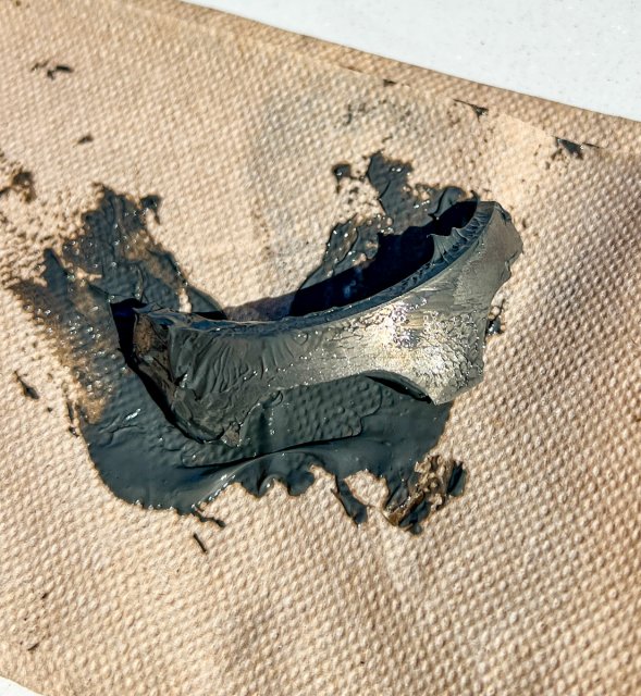

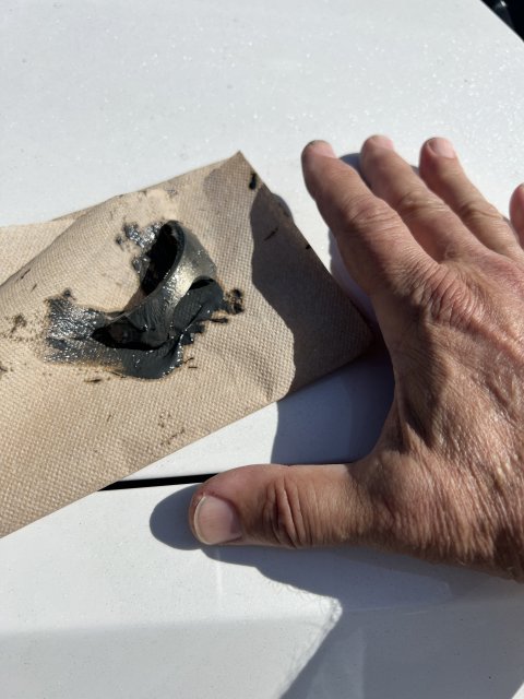

Just went to move the car to be towed and parts fell off with heavy grease on them. Small piece smaller than palm of your hand.

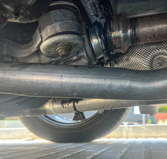

That looks like the cage of a CV joint, whether driveline or axle I couldn't say. I can't bring the image to my head without crawling under it but I'd have to think it's at the very least dropped a driveline. That would definitely make me wonder what the trans tailshft looks like. I'm just spoutin' off here.

Yes I believe you called it Gearhead I believe the transmission locked up when it down shifted hard and blew the u-join that’s what we’re thinking anyway won’t know for a couple days. here’s a couple more pictures
