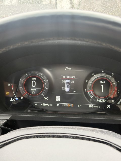

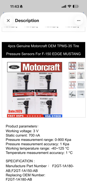

I recently put in my summer tires brand new never been mounted before and I bought Motorcraft 315Mhz sensors off eBay and they’ve been on for over a week and they never synced up my tire pressures were the number from my stock wheels and then today I get TPMS fault on passenger side rear tire. What’s going on? How do I fix this? I tried the relearning thing and it told me to go to front left tire and I went and let air out for more then 10 seconds and nothing.

unfortunately, other members have bought from ebay before and the sensors were dead. I bought a set from TPMSbargains.com recently--not the cheapest but wanted pieace of mind.

One thing I do and I use the cheap chinese sensors off Ebay. Is to let Discount Tire check them on the counter BEFORE you spend the money to put them in the wheels. Usually these are OK but I have had a bad one out of the box. Saves time and effort.

Hey if it makes you feel better you were right lol. I went to Flynn Auto Tires and they scanned my sensors said they’re good and then put my car in relearn mode and went around and scanned every tire and my horn honked every time and now my sensors work. So thank you for your advice.
