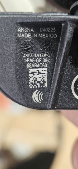

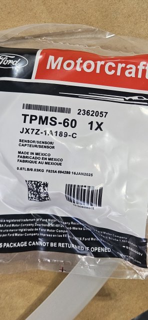

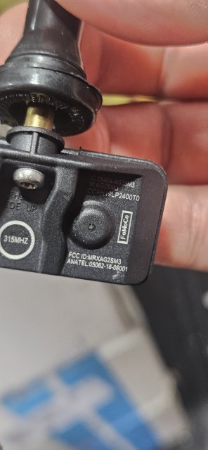

These look legit and seem like they were packaged in jan 2025.
I just don't get why they won't respond to the tpms19.
I heard that these ship in deep sleep mode and aren't wakened until they're pressurized or spinning.

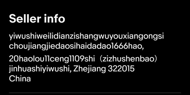

The TPMS19 would wake it up. Try sending a message to the eBay seller stating they don’t work and see if they don’t refund your payment. They refunded my payment right away without even replying to me! Seems you’re going through the same thing I went through. I’m telling you, TPMSDirect.com! Guaranteed to work and, most of all, they will last! But in the end, it’s your money.
