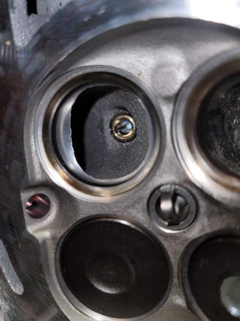

@ZFGracing you posted the below picture back in October 2021. Has a go-to vender been identified for head porting since then?
Also, I've been rocking a E50 and 93P ZFG tune (depending on where I'm driving) since month 1 of ownership. Thanks for everything you do for this platform!
I don't want to do any head porting yet. I think the porting that has been done in the past has been in effective/hurt the performance. I am looking into what can be done on the exhaust manifold side though, I have a pretty good plane there.
