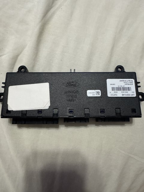

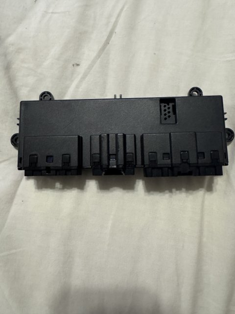

here is what the HVAC module looks like that they gave me
they are sneaky about covering original part numbers with those white blank labels

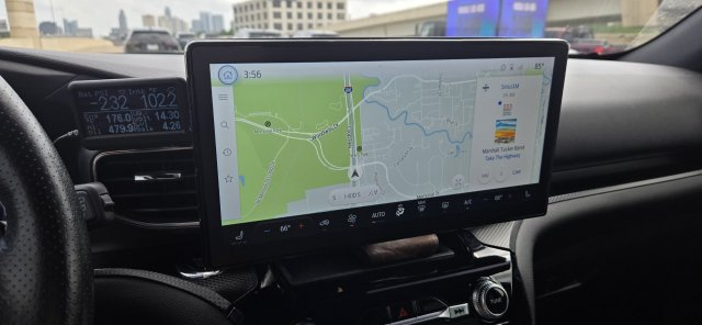

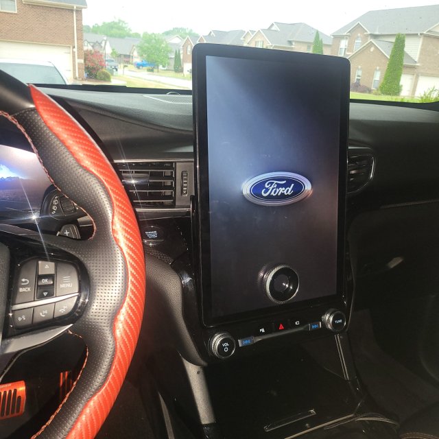

I been enjoying my 15.5 sync 4 swap
KoolAl44
54
Alabama
2021 Ford Explorer ST
#20
Only picture I could find. I also have the andriod box for it and It does wonders
