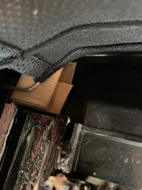

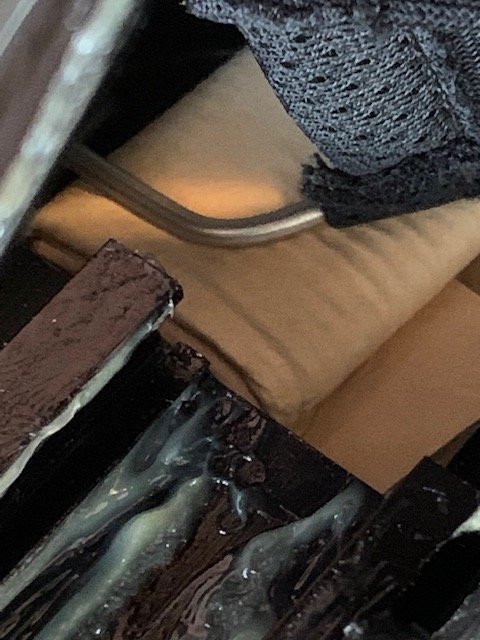

We use it all the time..
Also, got around to fixing the loud knocking sounds that was coming from the screen when going 40-90km
FYI:
If anyone wants to know of the quick fix, I read somewhere here or FB group that if you put a spacer between the silver metal bars on the inside/bottom screen and the base it will stop the noise.
It's about 3-4cm gap, so I used a strip of cardboard and folded it over a few times and the adjust accordingly from there.
Just thought I'd add that since we're talking sunroof. I wish I knew who gave that pointer and give credit. If anyone wants pics, let me know..
FYI:
Could you share a few pictures? Sometimes I find the open/cracked sunroof is loud at times.

Thank you for sharing the picture.
I'll take a look at mine to see if something is already there. I do not hear a 'knocking' sound but the wind is a bit loud on cracking open the sunroof (tap the forward button once on the sunroof).
