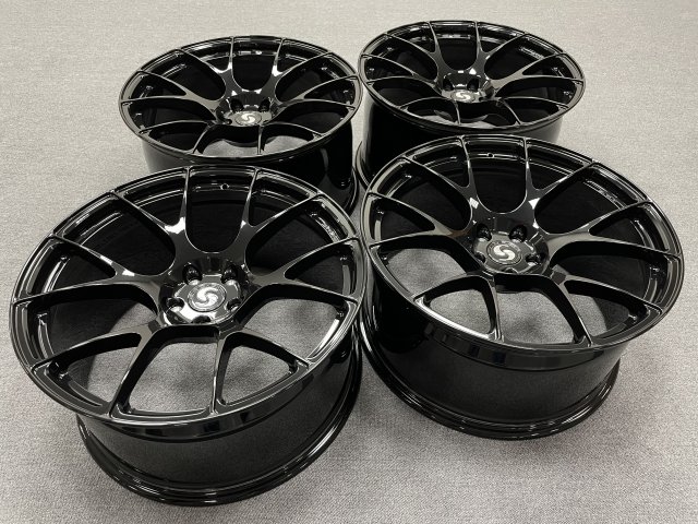

I have a staggered setup, I'd like to sell them too ($1000 off what I paid)
Same wheels and exact specs as the Ford Racing School Explorer ST
As UNBROKEN said, as long as the tire roll out (OD) is the same front to rear , there will be no issues.
312
313
Las Vegas, NV, USA
What's the specs for the set up? And price for sale? @ron@whooshmotorsports for the wheels above?
exact specs of the Ford Racing school Explorer
Track Series SV503
Drop Cup
Gloss Black
Vintage Color Matched Center Cap
Friction Lock
21x10.5
21x11
paid $5800 which was on sale @ Black Friday 2022
Selling for $4500 shipped to your door
message me with interest
