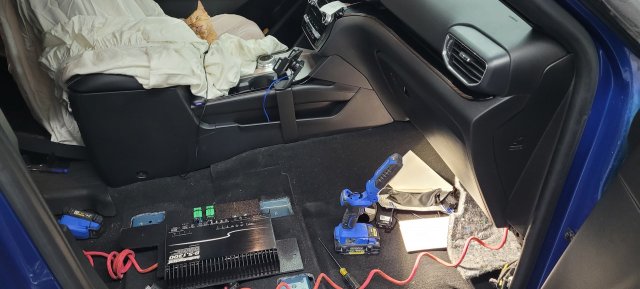

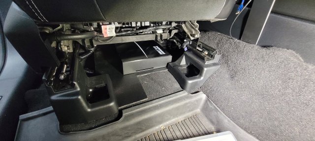

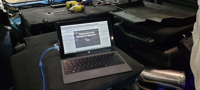

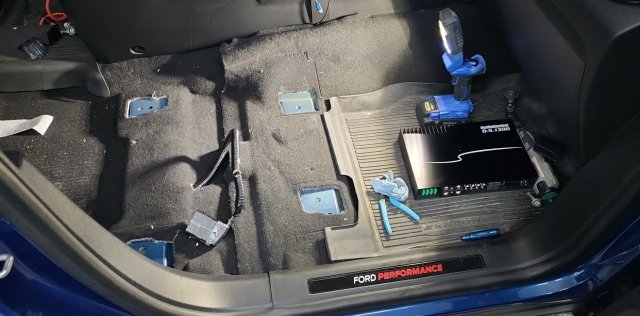

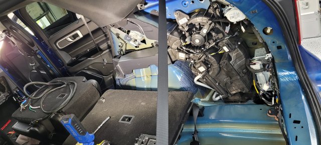

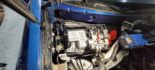

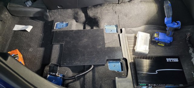

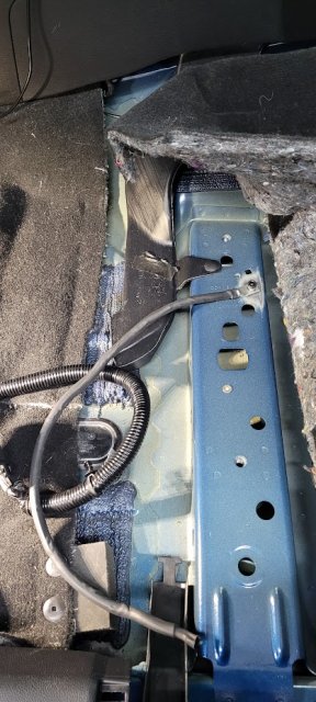

For speaker:
Front Speaker : Focal Inside IS FORD 690
Rear Speaker : Focal Inside IC FORD 165
The tweeters on the Focal are bright. Using my laptop to turn down the 8K for the tweeter make it sound much better on the ears.
I follow this video on the speaker and amp installed.

You did the doors only?
Also only using the audiocontrol for the input signal or is their another interface you are using in between?

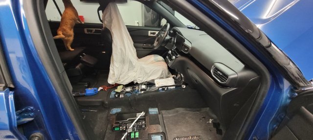

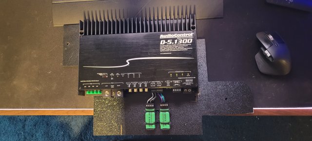

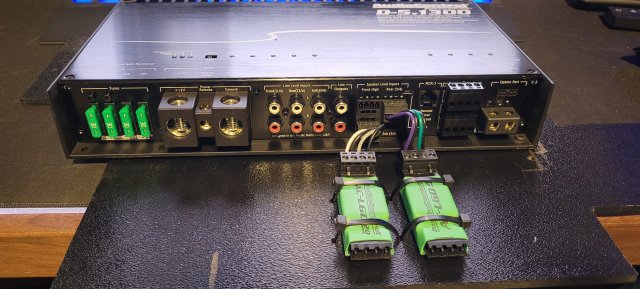

I replaced all the door speaker. I only have the 6 speaker setup.
The speaker are connect to the Speaker Level Input. Added a AC-LGD 20 Load Generating Device at the Speaker Level input.

This was the reply from Audio Control tech.
"I'm not 100% sure this vehicle needs LGDs installed. If it does, it would likely need the AC-LGD 20s similar to the non-amplified Ford Bronco but I haven't heard of the Explorers having any issues without them."
I just added them incase the radio freaks out and turn off the channel. Like the Dodge back in 2005.
But over all the system is working 100% fine and sounding good?
