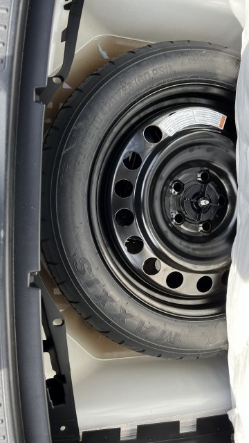

Has anyone had this issue? She’s 3 months old and the new car smell has now turned to a lovely mildew smell. We had a really hard rain yesterday and I noticed it right when I got in the car this morning. Checked all of the floors and in the back and couldn’t find anything. Went around a turn and heard a bunch of water sloshing around. The spare tire area was pretty full. This is very annoying. I specifically didn’t get a sunroof because they always leak at some point. I haven’t been very pleased with this purchase. Too many issues. I seriously would deter someone from purchasing one if they asked me at this point. Very disappointing.

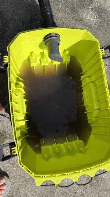

I definitely will. So it rained again today. There was another gallon. Still can’t find where it’s coming from. But I drained it and cleaned it all up. When I went around a corner after it was cleaned, I still hear a lot of water sloshing around. I can’t see it anywhere. I’m not happy.

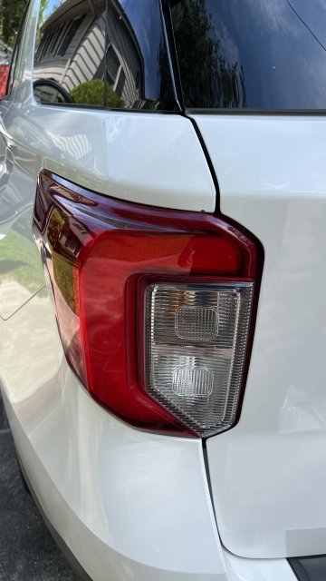

Explorer22ST
Canton, OH
22 Explorer ST
Well, not only is his spelling awful, but they put a chip in the paint right above the tail light. Can’t make this shit up.
