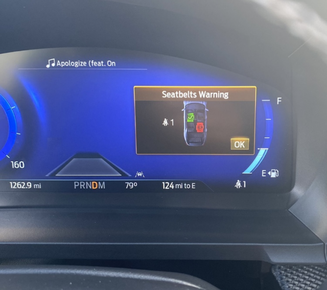

The display shows that the back two seats are occupied with seatbelt connected (green) and the other is red (occupied) but not connected. This is brand new and no one is in the bac seat. This is not the major issue. The issue is that the warning will not go away with OK. I restarted the car and still there. Is there a way to reset the dashboard? Or should I try to reset the SYNC and see if that is connected? thanks!

1704984982586.png something like this. I apologize, I copied the screen from another thread as I did not have a picture. But it is the above and will not go away with ok. I do wish it were 79 degrees here!!!

Nothing sitting on that seat is there?

Nope. But even in the past where something was on the seat, I could hit 'ok' and it would go away.
did you figure out how to fix this?

Sensor in the seat is bad and needs to be replaced.
