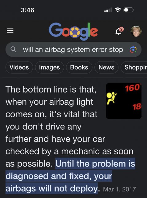

ThaNk you so much! I do see the airbag light is on. My next task is to see if this malfunction affects the whole system. (See pic) I really appreciate the time you took in helping me. IMG_1195.png

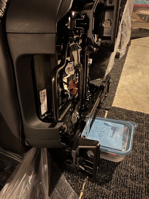

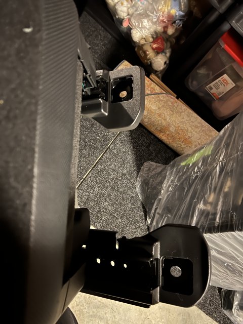

so you’ve help me resolve a few issues.. One module is on back order and the other sensor they can order so I’m thinking I’ll just use the modules from my seat and plug those back in after I remove the seat. So tonight I go to remove one of the captains chairs (2021 Explorer ST) and there are no bolts on the seat track. So I’m thinking maybe they are under the plastic frame the track runs in…I removed the little bolt and the plastic cap wiggles but doesn’t pop out . .. I can’t get that off without breaking a plastic piece. So why isn’t there a video on how to do this? And why is this so freakin difficult to do? So I’m asking for your help again…where are the bolts because there are none along the track …unless they just forgot to put them in! which I can’t imagine … where do I access the seat bolts? Thank you in advance.

Okay so I did a search for Police interceptor 2021 Ford explorer st remove second row captain seat and by golly found how to remove the seats. I’d film it but I don’t even know if I can pull that off…. Bolts located at the front of the seat below the rail and at the back inside the plastic cover ..pop off all four cover pieces and there’s the bolts! Now to find a socket. Thanks for all your help guys!
