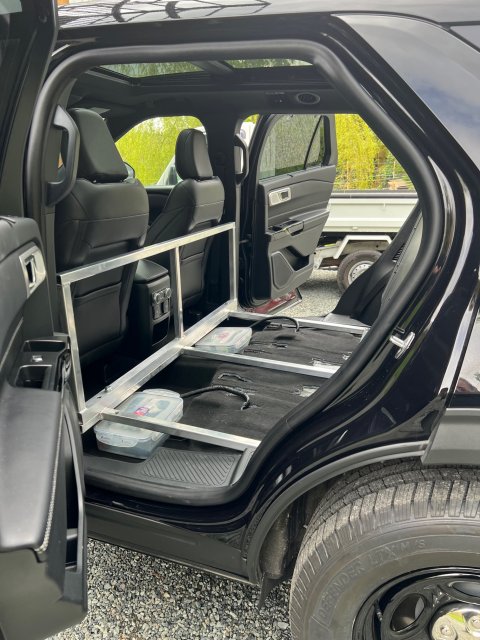

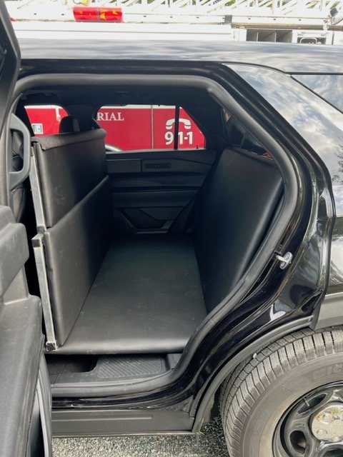

I did remove all three seats built an aluminum frame to support a floor and front section to prevent dogs going into the front seat area and fitted a Setina cargo barrier and door protectors.
I had to purchase two modules and seat belt anchor sensors which I reconnected and installed under the false floor.
That is the only way to avoid fault codes and still have fully functioning airbag system etc

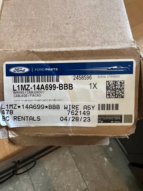

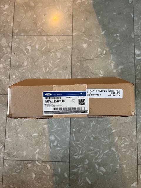

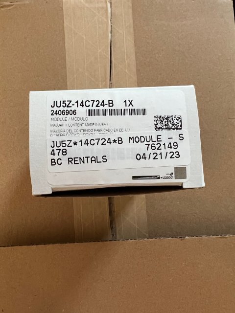

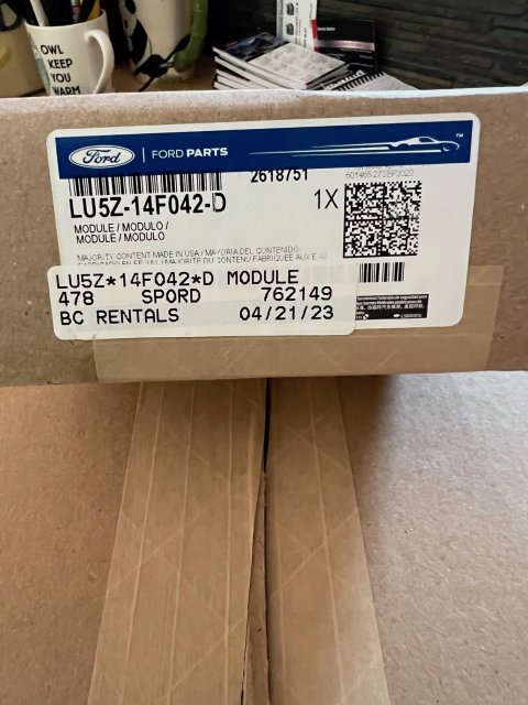

Thread Starter #17

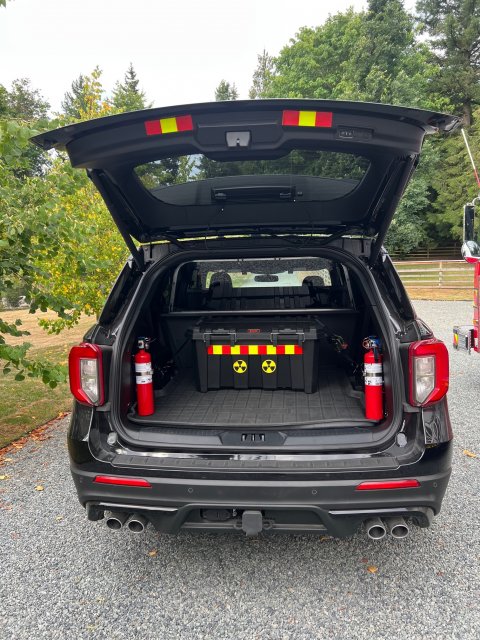

Here you go the two modules and two harnesses. In addition you will need the three seat belt anchors/sensors . As mentioned previously, if these had not been on back order I would have ordered them instead of having to remove them from all three seats which was a pain, to be repeated should I decide to put the seats back in.

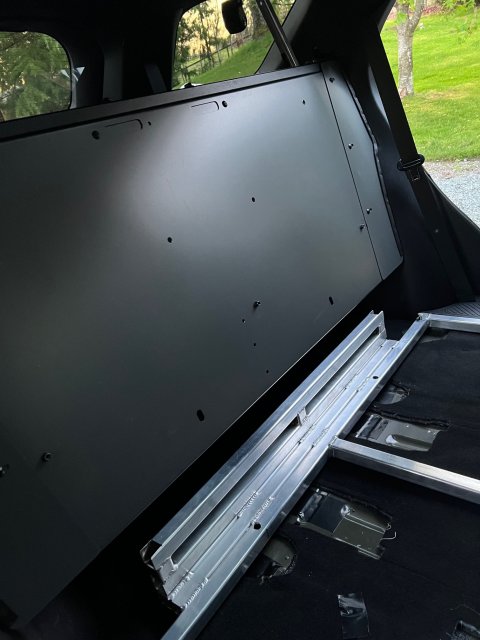

I have included a few shots of the frame and after completion. I use Setina products on all of my other vehicles and fitted widened OEM steel wheels powder coated with 285/60/18 Michelins on the Explorer which fills the wheel wells and gives the vehicle a wider and more aggressive stance. It is a personal choice but I have never liked the look of large diameter rims with very little sidewall on the tire and having a wider and smaller diameter rim allows for a wider tire with more sidewall which gives a more comfortable ride.
