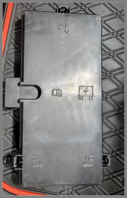

4th - Found this laying above the drivers side wheel well (under the hood) - couldn't find where it came from?

Thread Starter #19
Did a search - it appears to be a fuse box cover. Under the hood on the drivers side cowling is a removable cover. I opened the cover and their was an exposed fuse box. The only way this could fit is to put it over the fuse box and then place the cowling (with another access cover) over it (or something like that). Will show it to my dealer tomorrow and everything checked out.
