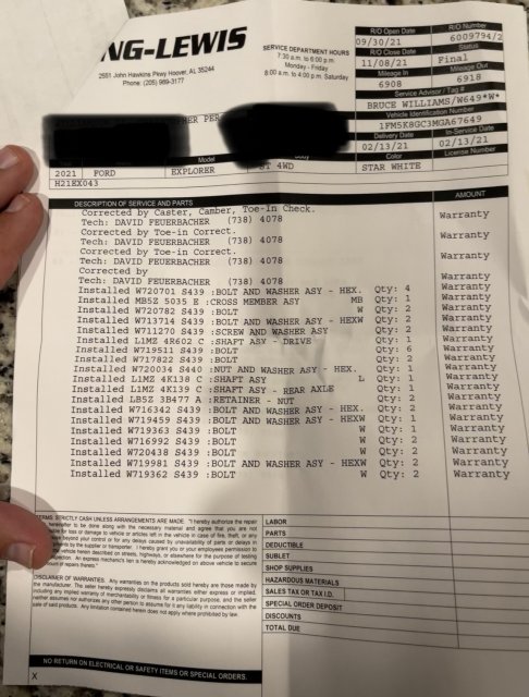

They replaced with the two rear bolt one!!
You wouldn't by chance have a copy of the repair invoice would you? If you do, would you mind posting it?
Dale5403

That had to be a pretty expensive repair for Ford to eat.
I’m sure it was not cheap. They wouldn’t tell me what the dollar amount was.
