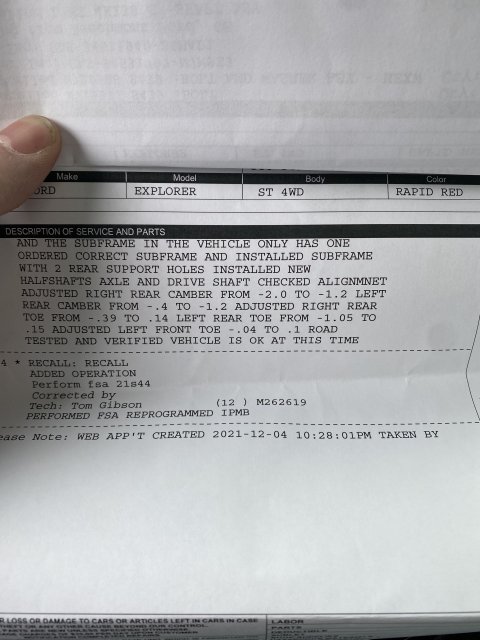

Hey guys just want to chime in here I have a 21 st with the lms stage 4 tune, whipple ic, jlt catch can, and an mrbp cat back. Car came with the 1/3 subframe, in December it failed. Dealer had the car the entire month of December due to back order on parts but they did replace it with the 2/4 subframe under warranty stating it was a mis manufacture.
If you can, can you post the work order that they gave you? I'm curious about their wording for this as a mis-build.
Redrocket
Warren, MI, USA
Hope that helps it doesn’t exactly state a misbuild but that’s what my service writer kept telling me

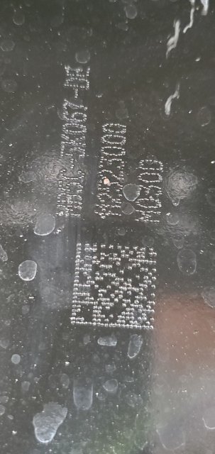

STOP! I think you have missed the details in my earlier posts. The MB5Z-5035-E is the latest version of the 4-bolt subframe for all applications that require 4-bolts. I have the correct 4-bolt part, that I ordered through TascaParts.com, sitting here (well, outside under my RV). Order the MB5Z-5035-E as it is the correct 4-bolt part. Note it took a long while to get it, so you won’t find one with persistence. Just order and wait…
Can confirm that mb5z-5035-e is the 4 bolt subframe as confirmed in the pic of my work order.
