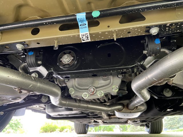

Does anyone have one made after the recall( build date after 4/11/2022?) If so is it one or two bolts?

I'm guessing this is the "one bolt" situation.
77
58
Maryland
Build date 3/29/22.

12/21 build date and 3 bolts not 4. Boo!
I hear 'ya, same here with an 01/22 build!
