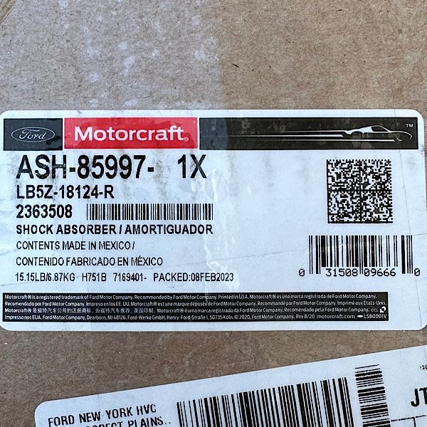

So with no Bilstein options (yet), I wanted a way to get firmer damping for my Steeda springs. The rear shocks replacement is an quick, easy way to see if Police Interceptor Utility (PIU) shocks offer more damping like some of the literature out there would suggest. I paid $103 each with $11 shipping from Levittown Ford. Part# LB5Z-18125-J. Install time: 10 minutes for each side. No alignment needed.
Box Label:
Old 2020 ST shock:
New 2020 PIU shock:
Initial ride thoughts: Definitely firmed up the ride. Feels more solid. There is also more road feel. Choppy roads can be penal. When I had both of them out, the PIU shocks are definitely much harder to compress by hand than my old ST shocks.
Reality check: my outgoing shocks had 65,000 miles on them. I would probably have the same impressions had I put in new ST shocks. There is no way for me to know how the PIU shocks actually compare to ST shocks when both are new. The only thing that can be said is that new PIU shocks are firmer than my old ST shocks. But I like them enough that sometime later this summer, I'm going to replace the fronts with PIU struts if there is still no Bilstein option.

Awesome. Thanks for taking the leap and trying these. I had a feeling they’d be stiffer since the PIU rear bar is 23mm compared to 21.7mm in the ST. These will be a great option for anyone who has a larger rear bar and wants to tackle some curves with less under-steer. Have the PIU rear bar comping for mine (the Steeda bar is covered in rust and needs to be re-coated), so might just add the shocks while I’m there. Total bummer that Bilstein hasn’t come through, but these will be a good start!

Installed the front PIU struts (LB5Z-18124-H PIU front right, LB5Z-18124-R PIU front left, $220 shipped from Levittown Ford) today. My Steeda springs definitely settled a little because I didn't need to use a spring compressor--just put a little force down on the strut mount and was able to thread on the top nut. I did reuse all other parts which seemed in good condition. Install took about an hour and a half. As with the shocks, the PIU struts were definitely much harder to compress than the old, likely worn, ST struts. The ride with both PIU struts and shocks installed is super nice. Very responsive and solid feeling. Car feels more stable but there is definitely more road feel so maybe not a good choice if you want more comfort. The trade off is worth it to me. Would definitely recommend if you need new struts and shocks, especially if lowered. I

The pictures that OP posted show identical part number PIU vs ST. They are the same exact shock/strut and there would be no difference in dampening, etc.
You are obviously not paying attention. The PIU shocks are clearly listed: LB5Z-18125-J. Those are not the same p/n‘s for the ST. Even in the picture, the engineering numbers are also different. Same goes for the struts. If the PIU and ST shared the same dampers, the part numbers and engineering numbers would be identical. That’s basically the whole point of this thread. Goes the same for the sway bars.
Here's a pic of a rear shock label of a 2.3L Explorer. Some part#'s are shared across the Explorers, but the other codes are different and the difference is in the details.
