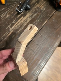

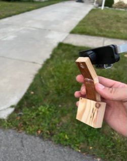

Went a little barbaric on a custom phone mount.
A little bit of shotty yet effective woodwork and refining.
Super glue and some black spray paint.
Tore apart an old swivel vent mount phone holder (my favorite style that holds the phone the best).
Paintwork is terrible but this thing does it's job! Large bottles and such cramp that top cupholder but that is rarely the case. Usually smaller Starbucks cups and they work just fine.
Also another issue is that I can't open that storage door.. but that "mount" is easily removable and I usually leave it closed regardless.
Cheers!
