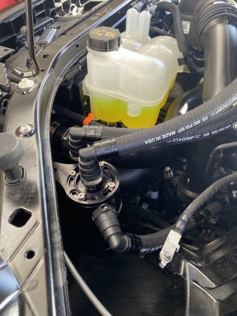

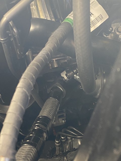

First mod to the 22 ST, the new version of the UPR catch can, no drilling required. UPR tweeked the design and have now added a “T” valve that the WOT hose connects to so you don’t have to drill 5BEE2443-2F5E-440D-85EE-85857721CF0B.jpeg 61299F98-9BF4-4D5E-9F3D-1428370AF845.jpeg

That’s nice. I hated drilling into the intake tube.

My first mod too! I just got it and was wondering if you have any advise on how to get the factory hoses off? The ones with the blue connections are easy its the ones with the orange that I'm having trouble with.

I bought a blue connector to take the place of the orange connector prior to removing it. Pretty much impossible to remove. It’s been done but only a couple times that I know of.

I just busted that sucker off on both of the pieces and used a heat gun to remove the blue connectors off the original cv tube for the clean and dirty side and used those for the intake and bypass valve

If you upgrade to the AFE intake you will need a shorter fitting then what AFE supplies. No room to reconnect the T fitting.
Just FYI
UPR gave me a shorter one.
