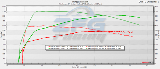

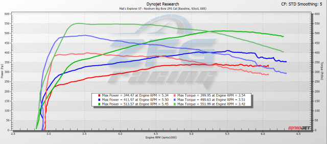

Tagging along with yesterday's post here are some more numbers to consider. This is Mathew Lloyd Tyler's ST bone stock vs and e85 tune with the new HPFP! 513 awhp and 551 ft-lbs! tuned on 93 it made 410, on the same dyno on the same day. That's right 100 hp over the best we could on 93 e10. I do recommend doing the intercooler along with this as well. H086-1182-1 Ford Explorer High Pressure Fuel Pump Kit.png stock vs 93 vs e85.png stock vs e85.png

Tagging along with yesterday's post here are some more numbers to consider. This is Mathew Lloyd Tyler's ST bone stock vs and e85 tune with the new HPFP! 513 awhp and 551 ft-lbs! tuned on 93 it made 410, on the same dyno on the same day. That's right 100 hp over the best we could on 93 e10. I do recommend doing the intercooler along with this as well. View attachment 8279 View attachment 8280 View attachment 8281
Hey Adam, this kit isn’t listed on the nostrum site. Are you marketing the hpfp kit?
