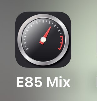

Thanks for the feedback. Regarding @mitchellj22 concerns about mixing, it is really not complicated at all. Tuners like ZFG are very good about configuring the ECU to detect and prevent knock and learn the fuel mixture over time. So if you have a 93 tune, you can mix up to e30 and make significantly more power. 93 already is already e10. So if you add a little bit of e85 to the tank the ecu will learn it will safely make more power.
To get e30 you add 70% 93 and 30% e85. it’s not complicated and the mix doesn’t have to be precise. Aim for e25 if you’re stressed about it. I’m not tuned yet but many people say e30 on a 93 tune makes significantly more noticeable power than you would expect.
It’s not 70/30% for E30…more like 26.5% using E10 93. 35% for ethanol free 93.
