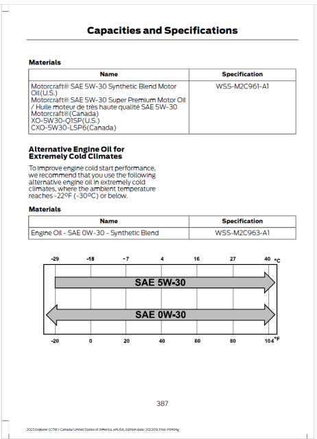

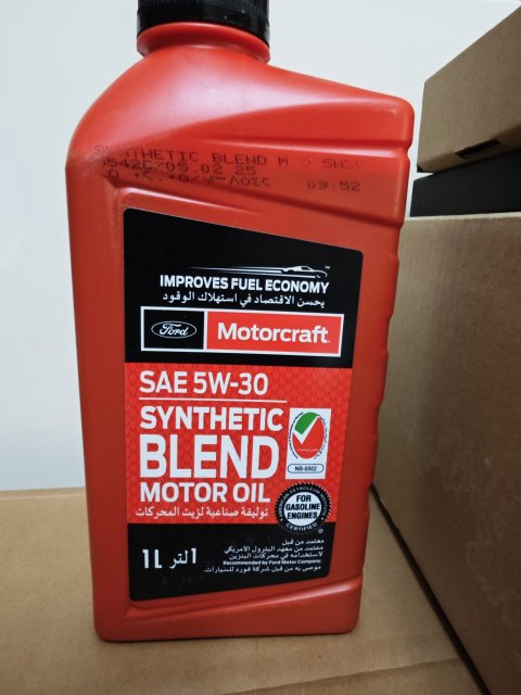

Hey everyone,
I just bought oil and filters from a local Ford store for my 2024 Explorer ST (currently at 5,000 miles). I asked for oil specifically for the ST, and they handed me Ford Motorcraft Synthetic Blend 5W-30.

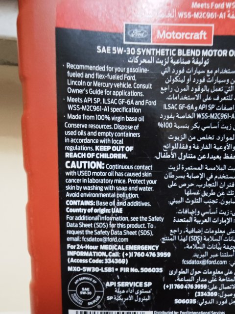

Once I got home, I noticed the label says "Synthetic Blend". I translated it and realized it means it's a semi-synthetic oil. Is that correct? Is Synthetic Blend actually just a semi-synthetic?
How critical is this for a '24 ST with only 5k miles? Should I take it back and swap it for Full Synthetic, or is running this for a standard 3,000–5,000 mile interval fine?
Appreciate any insight!

Running it is fine. It’s good oil though I prefer full synthetic.

So using Synthetic Blend is totally fine then?
The car is brand new with just 5,000 miles on it, so I honestly expected the store to hand me Full Synthetic. Sorry for asking what might sound like a dumb question, I just want to make sure Synthetic Blend won't cause any harm to the engine at all, right?
Also, I’ve heard that Ford actually fills these engines with Motorcraft Synthetic Blend right from the factory, not Full Synthetic. Is that true?

Yes it is synthetic blend. And yes it’s fine to run, I’d switch to full synthetic the next time you buy, but not a huge deal until then.
312
166
Farmers Branch, TX
It's literally in the owner's manual. That said, I have them use full syn.
