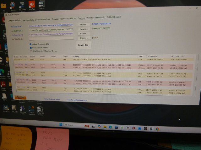

Didn't get to the car today, busy searching on the computer and I did find a neat program to open .ab files and do a lot more. It allowed me to load both my Continental as built files and one from a 2013 Fusion I had before the Lincoln and it highlights any module that is different. When I use the Fusion spreadsheet I will easily see which are different.
