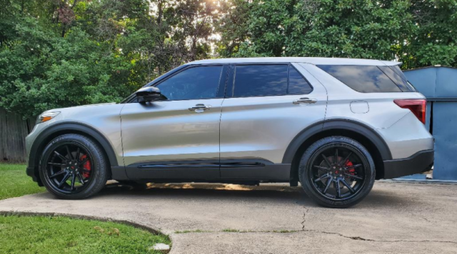

I have used both Steeda and H&R lowering springs on my 2021 Explorer ST. I am currently on the H&R springs. I also have the Steeda rear sway bar installed and was used with both spring sets.
I put about 8,000 miles on the Steeda combo. I have around 800 miles on the H&Rs now. While the Steeda lowering springs do not lower as much (especially noticeably in the rear) they absolutely 100% handle better than the H&Rs. They are more hardwired to the ground, and lateral handling and steering input is noticeably more crisp. With that said, the Steeda springs are noticeably stiffer, you feel bumps in the road more, but I wouldn't say it makes the ride harsh, unless you are going over pot holes or irregularities in the road, then it is more noticeably rough than the H&Rs.
The H&Rs are noticeably softer, and I noticed in comparison to the Steedas are a bit "floaty boaty" meaning the suspension isn't as responsive, or controlled and tends to float over bumps. It feels more like an SUV. The H&Rs are more comfortable, compliant and ride better especially on the highway. The floatiness I feel could probably be better managed with slightly stiffer shock valving. The Steedas have noticeably better lateral handling, but with less front end "unload" (weight transfer) during launches, which can make launching a bit more of a challenge with tire spin if you are drag racing.
With that said, I think the H&R springs are probably better for drag racing, while the Steedas would be the better choice on a road course. The H&Rs can sometimes "bottom out" (on road humps) in the rear (just have to go slower over speed bumps and road humps), there was no such issue with the Steedas, even with passengers.

Steeda side:
H&R side:

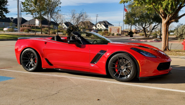

It could be subjective, however, I also drive a modified 2017 C7 Corvette Z06 and the difference between the H&R and Steeda lowering springs is about the same between Sport mode and track mode on that car. lol. It's noticeable. While the magnetic shocks are infinitely better at irregular vehicle movements, it's also much lighter, lower to the ground and different/better weight distribution (an SUV will be much more top heavy). I'm going more on steering feel and feedback between the steering wheel and the road, but also the floaty boaty feel during aggressive driving does not inspire confidence, especially when I need to change lanes at speed. With the Steeda springs, I feel more confident at high speeds, or at 8/10ths of the limit than I do with the H&Rs. That's something to consider at 100+ mph, even in a straight line. Springs are just one part of the puzzle when it comes to a vehicles handling charactoristics. It's not really the lateral body roll that makes me nervous, it's that the suspension overall seems to get more unsettled in certain situations. Like dips in the road make the front end wallow a bit during normal driving. While the Steeda spring might be a bit harsher, everything feels precise and under control. I noticed this my first drive back after picking it up that it just felt more "floaty" which equates to more "unsettled" especially when I'm used to point and shoot precision. In my opinion the Steeda springs handle better laterally. "Floaty boaty" does not mean body roll, it means lack of steering feel and the front end especially tends to raise and dive more during accerations and braking. These two springs are NOTICEABLY different. The Steeda springs make the Explorer ST feel more planted, more precise, easier to point and shoot... like the difference between a steak knife and a butter knife. lol :p The Steeda spring feels "sportier" and makes the big heavy SUV feel more like a sports car.
