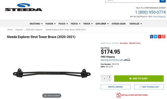

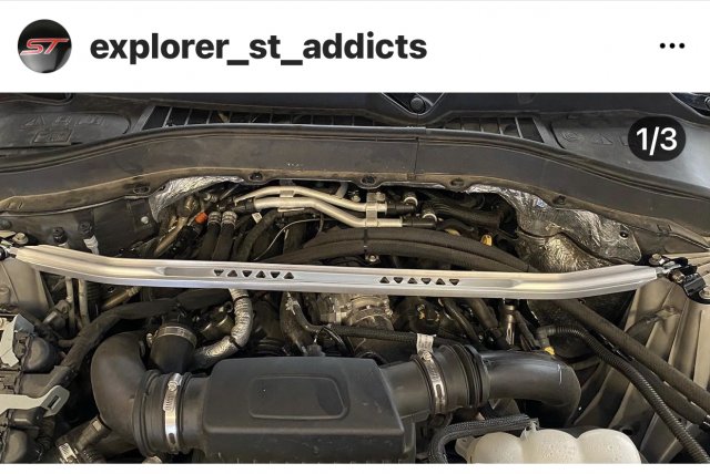

Just saw another strut tower brace for the ST. I'm sure it is more rigid than factory but I think I like the design and appearance of the FennFab brace better than this Steeda design. For a component like this I not only want it to be functional but also help dress up the engine bay as well.

I built my own. Same center bar FenFab uses. Less than $50 all in 36297BF9-6D41-465D-AE01-F82DD7A58C87.jpeg

The best looking one to date! I could see myself color matching the center bar itself to the body.

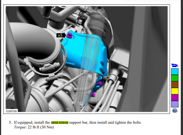

Steeda's instructions say to torque the bolts to the manufacturer recommended torque - does anyone have the shop manual that says how much this is?
168
64
Iowa
I believe it is 22lb-ft. for those bolts. I’ll have to see if I can find it.
168
64
Iowa
Yep, confirmed - I just bought the shop manuals - it is 30 N*m (22 lb*ft).
Awesome! Where did you get the shop manual from? I got my giant *.pdf from 'factory-manuals.com'. 2020Explorer_struttowerBar_TorqueSpec.png

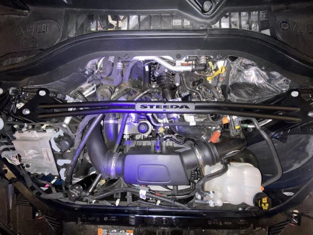

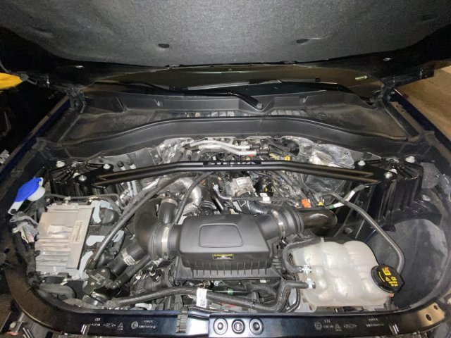

Here's a couple shots of the bar installed on my ST.
1,976
1,001
That brace looks sweet. Can you tell that it's stiffer than stock?
168
64
Iowa
To me, yes. A bit. I really like the look vs. stock too.
61
29
How did they do the underside of the plates? Are their spacers that slip on the bolts? Or are they welded on?
168
64
Iowa
They included two billet steel spacers for the front two most bolts (1 on each side). The two rear bolts (again, 1 each side) are reused from the factory. The instructions do show/mention it. :)
