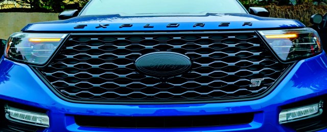

#80
I tired this few times and I was not successful in getting it to work as Amber DRL.
I kind of lost the white DRLs after making the change, and then I reverted back.
Will try again.
Finally I was able to make it work. Thank you to everyone here and other ford forums.
Details in the build thread.
