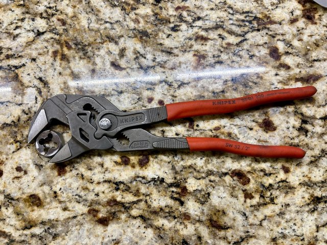

It’s no joke that the threads for the flare nuts on the hard lines are beat up from some kind of weird/aggressive install method at the factory. It ends up making the flare nuts slightly oval shaped and mangles the treads a bit. I have installed a bunch of brake lines over the years and had never seen anything like this from the factory. You’ll definitely want a M10-1.5 die. I purchased 2 Irwin brand dies from Amazon and cut one in half using a cutoff wheel. I believe that tip (cutting a die in half) was from @UNBROKEN on another thread somewhere but I apologize if I’m mistaken and it wa someone else.
Cutting the one die in half allowed me to place it around the base of the flare nut, and then unscrew the nut it to clean up the threads a bit. I skipped using a die stock, and instead used a pair of Knipex 7 1/4 pliers to hold it. These are basically fancy slip-joint pliers, and using them allowed me to selectively apply pressure to the two die pieces as I worked to initially clean up the threads. Once I did that, I was then able to thread the intact die onto the flare nut the “correct” way to complete the clean up of the threads on the flare nut. Plan for each flare nut to take 5-15 minutes to complete the process.
