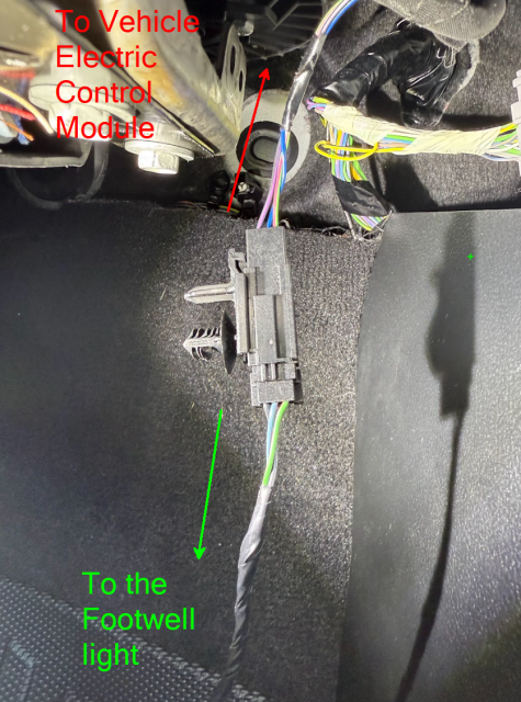

I decided to tap into the Passenger Footwell light wires. These instructions should work for the Driver's side Footwell light connector as well.

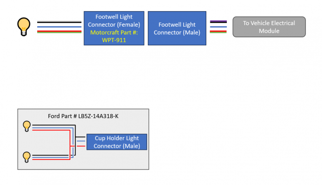

There are 3 wires that power the LED light:
  1. One wire is ground
  2. Two wires are digital signals sent to the microcontroller for the LED light. I assume they control luminosity and color.
I believe ground is black and the blue and green/red are the signal wires (I didn't bother to measure the voltage and did not have the wiring diagram available to me).
The LED lights and harness for the Cup Holder have the same wiring configuration as well (black is one side, blue is in middle, red is on other side of the connector housing). The wires are actually black/grey or black/purple, blue, and red/green, but I'm going to just refer to these wires as black, blue, and red.
Here is what the Footwell connection actually looks like:

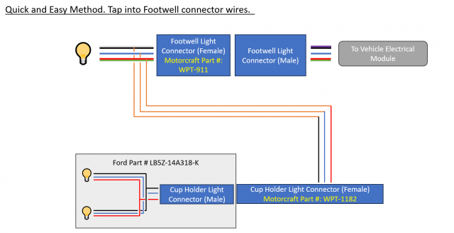

Quick and Easy Method
If you don't care for making the wiring "pretty", you can just buy one pigtail (Motorcraft Part #WPT-1182) and use wire taps to tap into the wiring for the Footwell light. You will need to get extra wire, wire connectors, and wire taps as well to make it all work.
Be sure to match the wire colors up when you're taping the wires:
  1. Black taps into Black
  2. Blue taps into Blue
  3. Red taps into Red

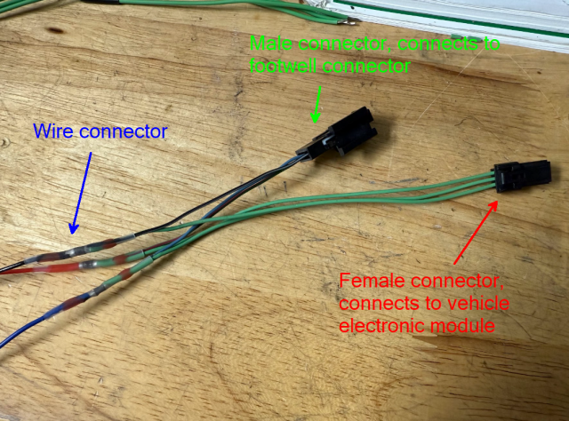

This is what I opted to do. I got two additional pigtails to create a Y-style harness that is plug-and-play (no wire taps). In addition to #WPT-1182, I needed to get:
  1. One #WPT-911

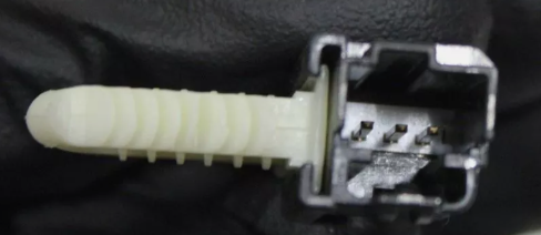

  2. The male equivalent for #WPT-911
Due to my lack of experience working with modern American cars, I couldn't figure out the actual connector or pigtail part #, so I resorted to sleuthing around on eBay and found out that the footwell light connector for the non-ST version of the Explorer had the male connector (connector with the pins).
Here is the part number for this footwell light connector:
#LB5B-13E721-AC
Once I have all my connectors in place, I used solder seal connectors (it's a combination of solder and heat shrink tubing) with my heat gun to create the Y-connector:

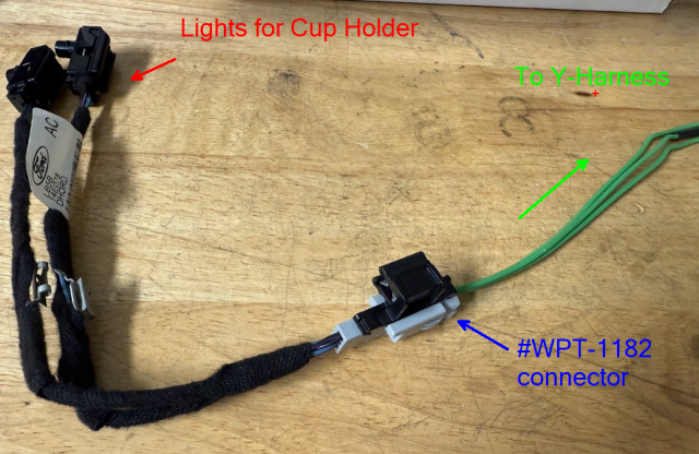

I then used another set of wire connectors to connect to #WPT-1182 which connects to the Cup Wiring harness.
