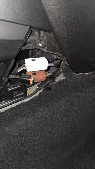

Here is what the Footwell connection actually looks like:

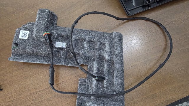

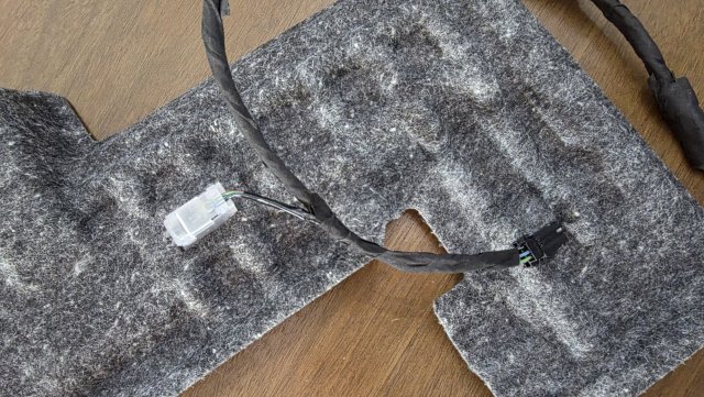

Once I have all my connectors in place, I used solder seal connectors (it's a combination of solder and heat shrink tubing) with my heat gun to create the Y-connector:
I then used another set of wire connectors to connect to #WPT-1182 which connects to the Cup Wiring harness.

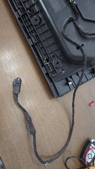

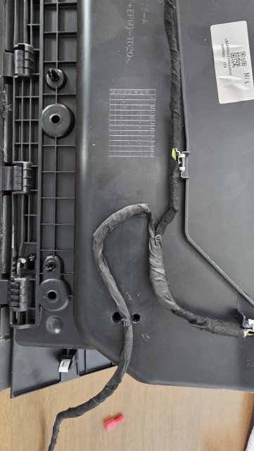

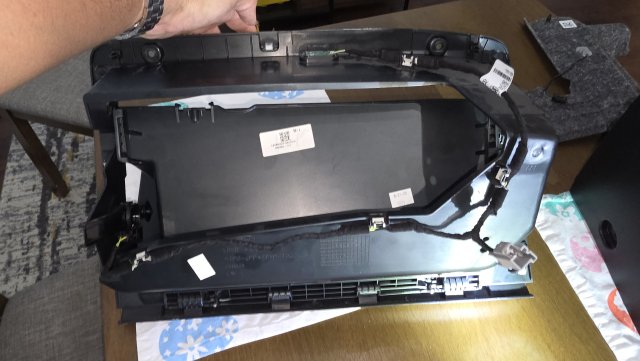

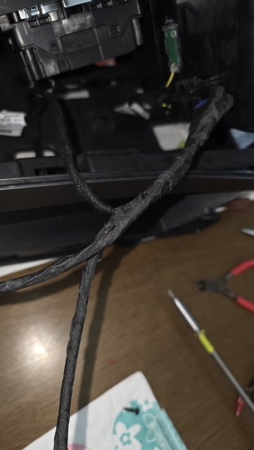

I installed today and nothing works :). It was getting late so made it fast without controlling, probably wire taps are loose. I used wiretaps everywhere. I didn't want to cut sockets. But i think its gonna change. This weekend I will for check all. For glovebox I found another line from front box with the USB's. I got power from there and extend it for armrest also. Tapped a Y. One end to glovebox other to armrest. I got the 3 wires from passenger footlight to cupholders. Made 2 sockets (Glovebox and Cupholders) to right side of center console to easily remove console next time. I don't like to hack and made up parts but i already started to hack so i will put a switch to armrest. I couldn't find a switch like in the glovebox. I will 3d print an arm for the switch and install it. I didn't order yet armrest lights. I wanted to see and figure out what to do. But I already pull the wire. So no need to remove console to install that.

It turned out to be loose wire taps. I guess they were bad ones. I ended up cutting and soldering the wires, and now everything works.
As you can see in the picture, I printed a leg for the armrest box, but it hits the sockets on the panel. It needs to be shifted about 2 inches to the right. I’ll fix it once I get the light harness.
