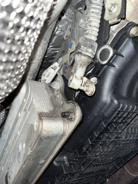

ok I found last night that there is a hose and a white plastic plug in it below the engine/ transmission. any idie what that is, it was leaking either oil or tm fluid.
post a picture

is this serious?

is this serious?
A transmission leak is yes serious. On our 2020 the transmission was leaking and it turned out to be a bad transmission gasket. I would let know who you bought it from and ask them to rectify the problem.
