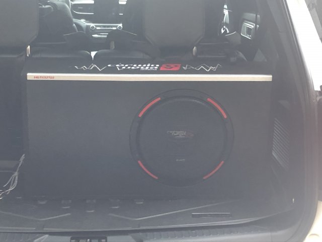

I added a powered cerwin Vega 12”. I used the stock sub wires for signal and the high inputs on the amp. It hits hard but the bass fades at high volume, if I turn it down and back up it’s sounds normal and fads (lessens) again. Any thoughts?

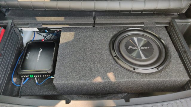

I installed a 12 pioneer sub with a pioneer amp fed from the stock sub high level inputs. I used an oscilloscope to check the 40hz -5db waveform and the stock head unit does not clip at all up to 25. I didn't go any higher as I didn't want to damage the speakers. My sub setup does not roll off any bass either.

I picked up the ground in the back of the trunk, left side. There is a factory ground point available right on the floor tucked in the corner. I didn't do anything with forscan. Just wired, set the gain and done. Trunk rattling bass.
