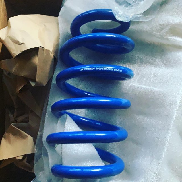

Scheduled installation w/ Steeda next Friday, 7/10/20. I’ll post pics and share some feedback or any issues.

Define perfect? Do you have the alignment sheet or in particular the rear camber numbers?
Perfect to me is not pulling either direction like the old days when we would lower a vehicle . I am not going to take it to the alignment shop or anything until i get the wheels on .
