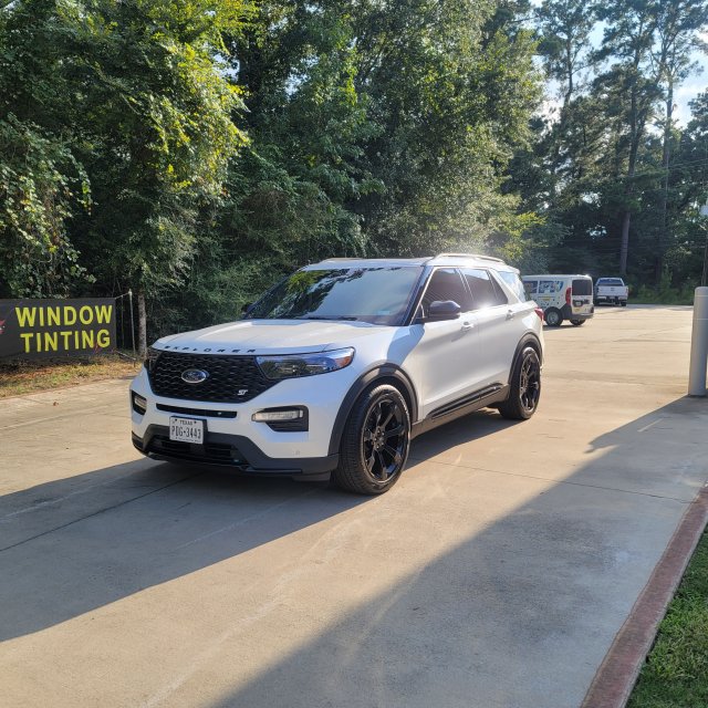

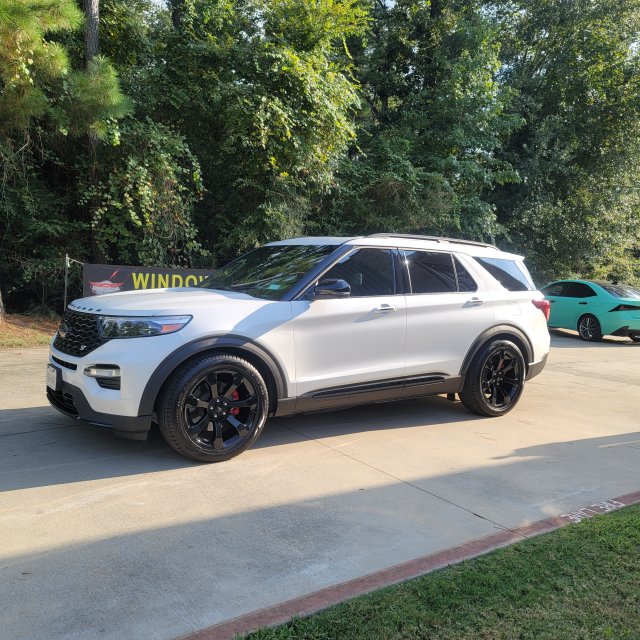

Thanks Ray! I absolutely love this Explorer and I'm sure you will too.. No vibrations, tires are wearing evenly, and the spacers imo are necessary for the right stance w/the stockers.. Currently I'm trying to procure a couple extra 21" wheels to send off with mine to be widened. I like the look of them, just needs a wider tire to complete the look and provide the grip needed for this E50 tune I'm logging w/Adam.. Just got her ceramic coated with some PPF in select spots specifically the piano black pieces.. 20210817_180921.jpg 20210817_180932.jpg

Thanks Ray! I absolutely love this Explorer and I'm sure you will too.. No vibrations, tires are wearing evenly, and the spacers imo are necessary for the right stance w/the stockers.. Currently I'm trying to procure a couple extra 21" wheels to send off with mine to be widened. I like the look of them, just needs a wider tire to complete the look and provide the grip needed for this E50 tune I'm logging w/Adam.. Just got her ceramic coated with some PPF in select spots specifically the piano black pieces.. View attachment 7403 View attachment 7404
Very cool indeed.....hr springs with borla spacer?
Thanks! And yes, hr springs, bora spacers, and Steeda sway is a great start for stance and handling.. Catch can, ic, Thermal exhaust/FFdp's, plugs, and tune after that and it's almost a perfect package, imo.. Now it just need some meats on the back! I don't know how hard the water is where you are but I wish I'd have done the ceramic coating before anything else, such a difference, the way the water beads now is hypnotizing lol
