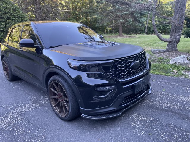

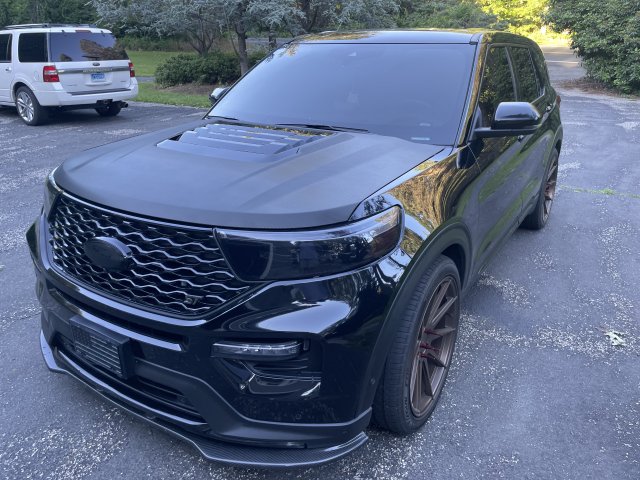

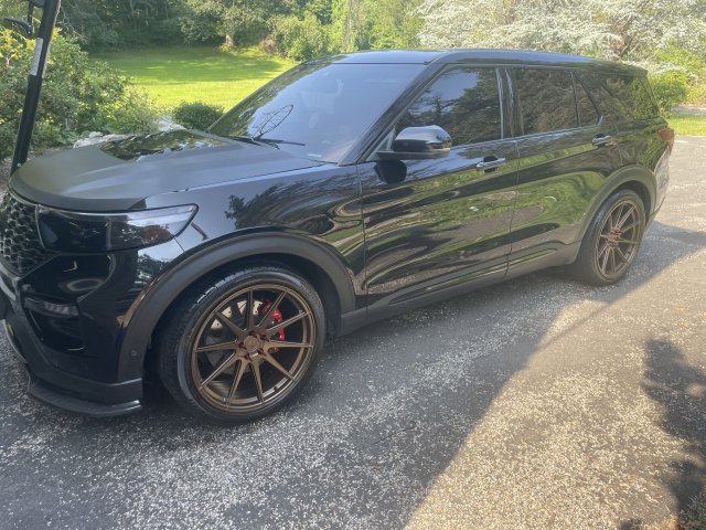

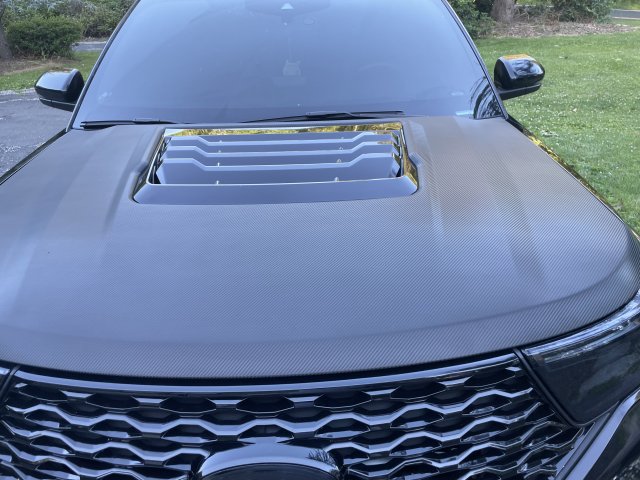

I mean i do have a Godzilla badge and the eye is red.
1,695
1,147
Looks as fast as it is!
