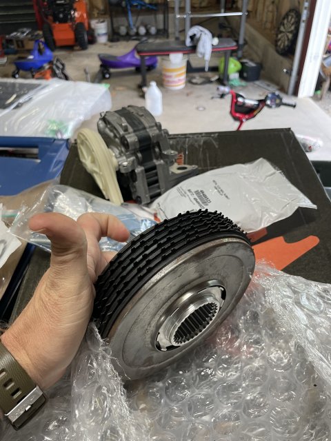

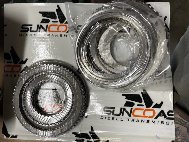

Pinion bushings and HD pinion bolts are going in.. I finally did it and bought the stage 3 suncoast rebuild kit… 10% off through tomorrow .. saved me almost 400$ so I basically got fluid for free… got the roof rail delete installed and I’ll upload some pictures tomorrow.. literally only thing left to upgrade is rear axles (when they break I will) and I’m going with the raptor hood.. and I’m ☑️’d off the boxes I wanted.. dyno day next Wednesday!

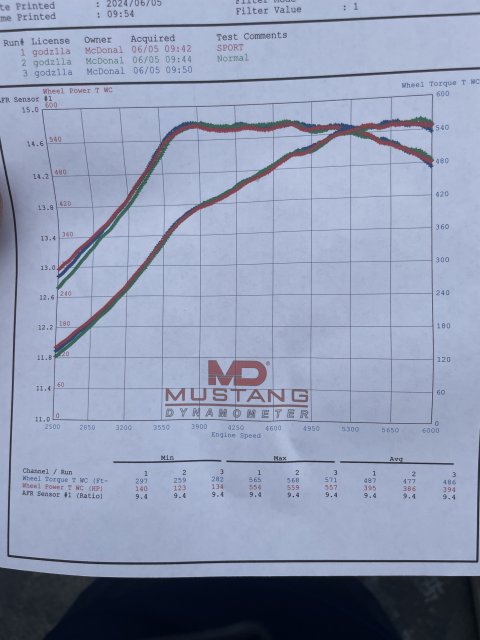

Well.. I was unable to get a pull in sport mode - when i jumped on the dyno and they were calibrating the speed it defaulted into normal mode.. and would not allow me to change drive modes.. All 3 runs were basically identical in normal mode making 560whp - 570wtq. also i just got done testing the ethanol i used and i took the pump at face value thinking it was almost at 85% E.. unfortunately it read @59% E.. meaning with my mixture im somewhere around e28-e32 in the gas tank on an e50 tune. Im happy with 560 in normal mode on an e30ish blend.. waiting for ZFG to get back to me on to correct the dyno issue and allow the cpu to change drive modes while on the dyno. Also this was my baseline e50 tune and still have 10-12psi of boost available and can push more fuel/air/timing once i get TIP/MAP sensors working(replaced).. Anyone have any ideas on the drive modes on the dyno? and why it defaults to normal even tho i entered the dyno in Sport mode - having the DMS tune i can assure based off of my 0-60 times im way more powerful in sport than normal - Best Normal 0-60 was 4.19 and sport mode was 3.54 on the baseline tune. So im thinking im significantly north of 600whp in Sport mode - but cant get dyno proof - yet..

This was a mustang dyno, so if you make the typical correction mustang dyno whp (559) x 1.13 I’m making 625 plus in normal mode and around 670+ wheel in sport running E30.. I scheduled a dynojet next week and upgraded the tune to a E60 competition tune. I like the correction to the mustang dyno #s lolol!

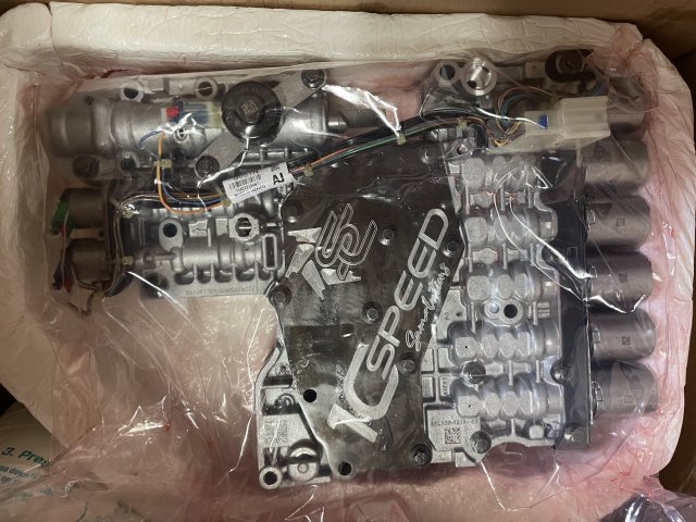

I’m coming for the 1/4 mile record!! Transmission stage 3 here we come .. just looking at the pro loc valve body makes me feel faster! Lol

Dyno jet #s were 639whp in normal mode in the e50 tune!! Running 47% ethanol.. the E in CT is all over the map.. got the ethanol sensor headed my way with the p3 gauge.. no more testing or guessing!!

Crazy how big of a difference the mustang dyno vs the dyno jet.. 80whp difference.. however I was was closer to E50 fuel when I did the dyno jet pull, again I was only e32 when I hit the mustang dyno
