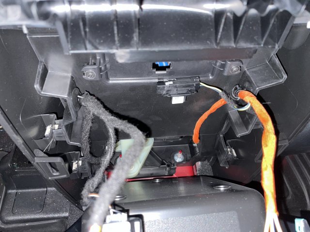

The console back simply pops off with no screws to pull just pull straight back an interior plastic prybar is helpful but chances are not it's not necessary. It's a 5-minute job to check. If I looked there and didn't see one, I'd assume the front one isn't there either.

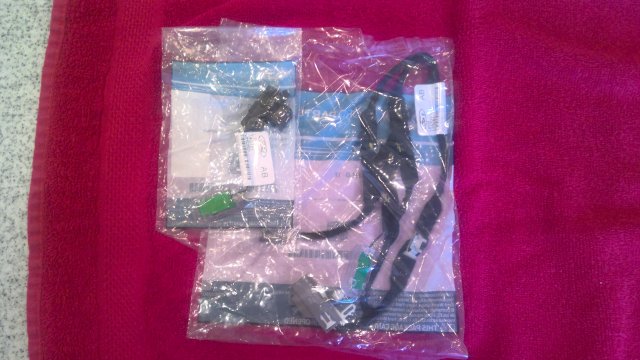

I'm just reporting back. With parts in hand, now largely disappointed, and feeling a bit foolish, I can confidently tell you that my Xploder with a build date of 3/21 does not have either of the wiring connectors in existence to add the lights.
I'm not going to be opening up the wiring harnesses to add them. Learn from my mistakes. As was discussed earlier in this thread, don't be lazy like I was and I knew I was being lazy. Check for existing connectors before ordering the parts.
Somewhere along the line, Ford figured out the extra wiring laying around unused costs them money. :cautious:

Heck no, if somebody else learns from my mistake, all is well. I was just overly optimistic. I knew better, and I should have checked. Hindsight is of course always 20/20.

Wonder where those 2 wires feed to. I’m wondering if we could tap into the light adapter in the front cubby. Maybe I will take apart my center console to see if I can find a place for them to feed.
