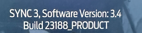

You definitely are on 23188 right and not an older build? The error about mm_cfgbuilder is normal going from certain alpha versions to beta because of the new patch to add the Ford icon to CarPlay UI.
2,134
1,081
2026 Explorer ST
#59
Yes, 23188.
Dukes
Canada
#60
My logs look the same and I am on 23188.
