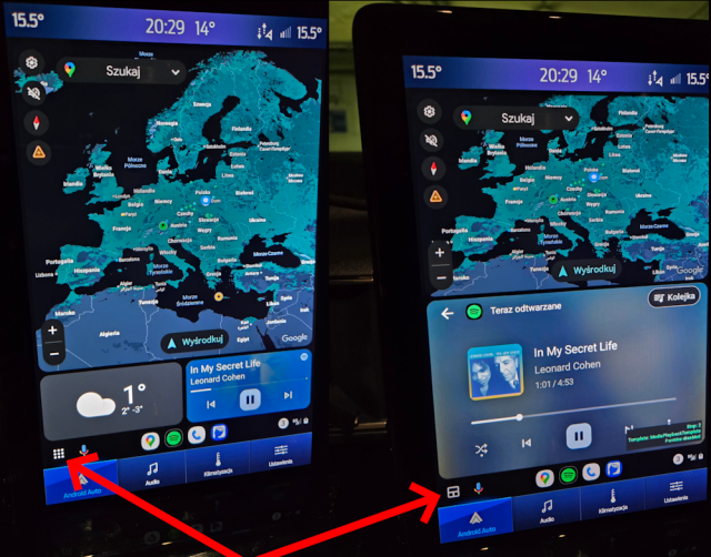

@ilovepancakes How do I get this screen? When I cycle through the different screens, I only see one with three apps at the bottom and the map at the top. I prefer this one because the map is larger, and the two apps at the bottom are smaller.
Btw awesome work! So far I am loving it.

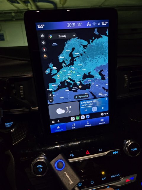

#28
to switch the view use this button in the lower left corner, which changes its icon

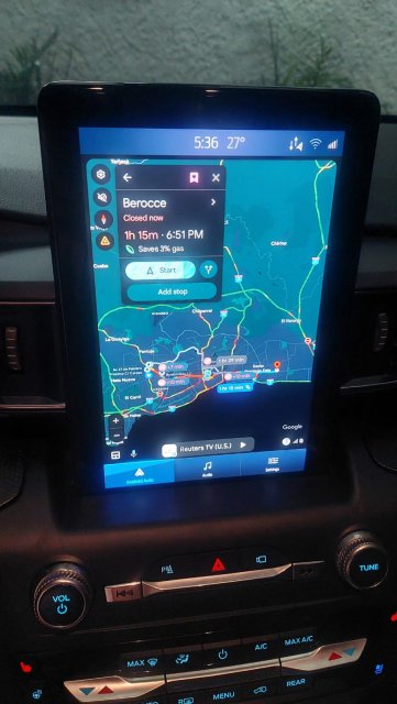

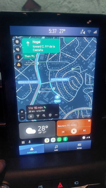

Twin Panel
Minimized App
